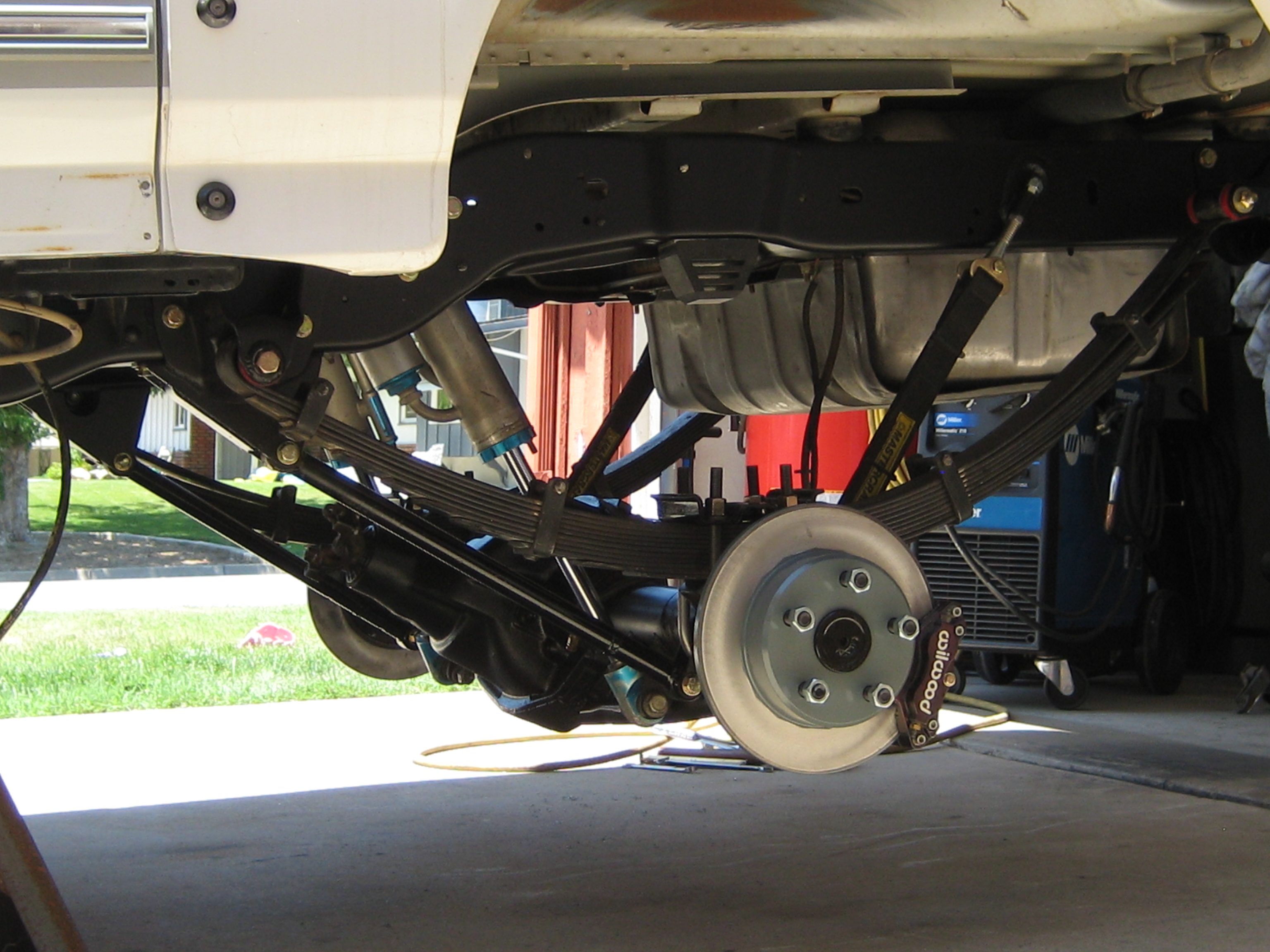

A Threat Motorsports, and or Solo Motorsports, shock mount. will not work with a 14" stroke shock on a Bronco..arse_sidewards wrote:About 14 minus the down travel from ride height... give or take a little since it's probably not 1:1 stroke:travel.Andy Jones wrote:Stick a 14" stroke shock under your rig, and see how much Bump travel there is !.
You could stuff it outboard so it's almost parallel to the ground on full compression and keep full bump travel. Not saying that would be a smart idea, but you could do it. The kind of valving you'd use at that orientation would probably cure any axle wrap issues.
A Truck.. Yes..
