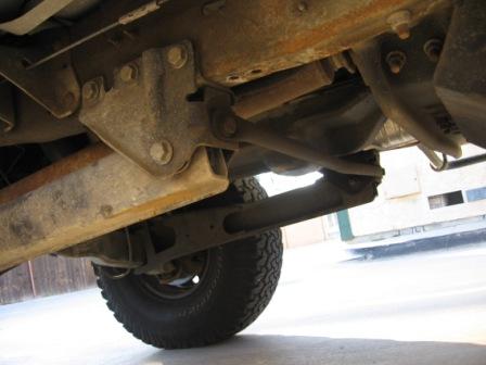

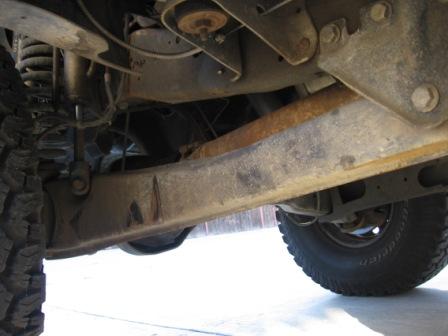

Spirit used to extend the stock radius arms and add a lot of gusseting. The Spirit-built BFG Bronco has stock/extended radius arms and tens of thousands of off-road miles.[HBW]22 wrote:I also have another question. I have stock radius arms with those ugly drop down brackets. I was thinking of boxing those in and extending them and putting heims on them. Has anyone extended their stock ones? or is this just a bad idea?

Okay does anyone have pictures of those off the BFG bronco?

- Posts: 6142
Re: SAS or leave TTB
Yup.[HBW]22 wrote:Okay does anyone have pictures of those off the BFG bronco?
It's not as simple as cutting and adding a tube, though. You also have to correct for caster. It might be easier to start from scratch.
- OR-Expo03 (31).JPG (829.57 KiB) Viewed 2433 times

Thanks man those don't look to bad. Has anyone made any from scratch on here?
