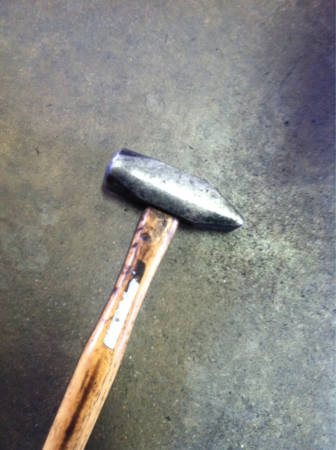

No pie cut. Just hammer that thing flat.
One of these will do the trick.
