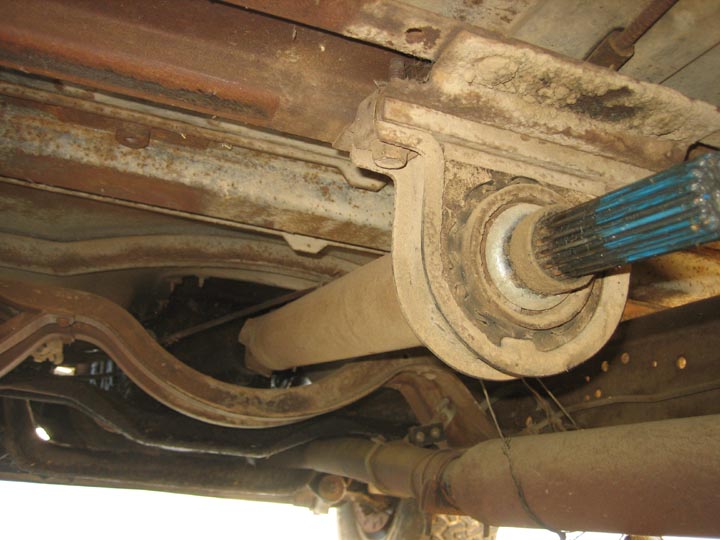

I am trying to decide how to mount the gear vendors... Right now my c6 has the fixed tail shaft (3rd pic) because it is shorter/stronger. I'm getting mixed opinions on how to mount it though.

Right now from the back of the slip shaft on the tranny to the middle of the carrier bearing on the supercab is 29 1/4"
from the middle of the carrier bearing to the center of the U joint at the pinion is then +/-50" - making the rar drive shaft like 48-50"
If I bolted the GV to the back of the c6 using the long tail shaft the rear drive shaft would go to about 61"
If I went the other route I'm not positive on how long the "short" driveshaft would be or how long the rear one would be seeing as I don't know the dims of the fixed yoke front joint for the GV.
Pics below:
1st = what's in truck now. Didn't come with a rear shaft - so this shows back of trans (long tail housing) to carrier bearing.

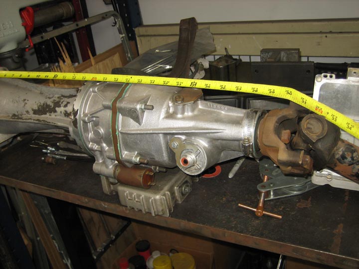

2nd = 31" overall length of GV setup with long c6 front housing.

My thoughts are that you will end up shorter if you mount it as one unit instead of divorced. I also feel it gives you better reliability in he event you are beating on the vehicle. I dont have any firsthand experience but more than once I have thought about this setup. either way your going to lose length on the driveshaft but I feel that you would lose less by keeping it together. Please keep us posted on the install I am curious to see how this goes for you.

I would go with bolting the overdrive unit directly to the trans.
One, it will be easier.
Two, with a divorced unit the engine will flex and the overdrive won't requiring a slip joint in the first and second driveshaft.
C, the mount will for the overdrive will have to be hella strong (see One).
Five, you should be able to run a single drive shaft. Your drivehaft will need a larger diameter to accomodate added length. You are at the limits of length depending on the driveshaft speed. This would be my greatest concern.

As for the GV flexing - I don't trust a tail housing this long so if I do solid mount it to the tranny (looks like I am going to) I will also make a bushinged hanger mount for this thing.
